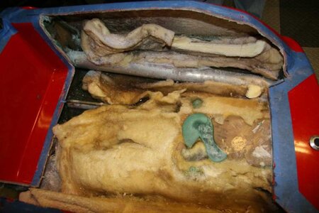

Ok, my foam is waterlogged because the previous owner of the ski installed the footholds incorrectly and said they were "professionally" installed. they were not glassed and the tray wasnt sanded before glass and turf so obviously the previous owner was clueless. Anyways I have been searching around the X for refoam threads and have found a few helpful ones but i still have questions. I was thinking of going the polyestrine route. I have never done glasswork before. so how much glass and what type should i use and how much polyestrine do i need? do i just use the same epoxy resin and hardener that is in the footholds FAQ thread? ive been looking on u.s. composites looking around and there is a west marine right up the road from me incase i needsupplies any tips or advice is much appreciated as im 14 lol. here are some pics<br>

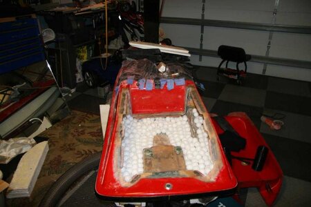

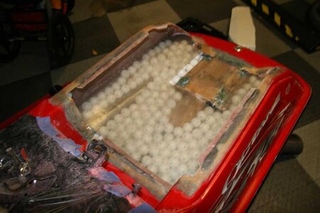

If its of any interest to you, I "beer pong balled" my brother in laws Octane. I estimated 30 pounds of additional weight in the tray from that wet junk, you could hear it sloshing around in there. Its been 18 months now and I'm completely satisfied with the balls. Unfortunately despite our best efforts to seal all possible leak points from the inside out and outside in, it does still take on water albeit at a much slower rate, say a shot glass after a full days ride, but at least this way there is nothing to absorb the water, and with the addition of a drain plug it just runs out from between the balls. Thankfully my RN is dry as a bone but i recommend the balls for simplicity and clean job

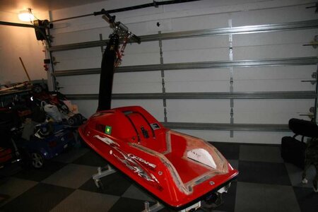

Probably 80 hrs into it, including carbon and glass work. It has been well worth it, but like I said it still leaked. I used a PWC doctor drain and now its always bone dry. I will most likely buy an aftermarket hull next as I feel its not worth it, I think I spent a grand doing it.

thanks fopr the idea and pictures Iland Trader
I've done a few so far here was a link to my first one. They all still leak, so install a drain
http://www.x-h2o.com/threads/66181-05-SJ-styrofoam-refoam-and-reinforce-job&highlight=
