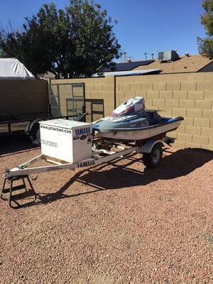

Also my buddy hooked me up with this trailer, exactly what I'm looking for! Plan is to go through it and clean it up, maybe flat deck it, we'll see. Right now it's gonna stay ugly as I'm going to do all the body and dirty work to the hull, final assembly will happen in my shop on my bike table probably, then I will go through the trailer.

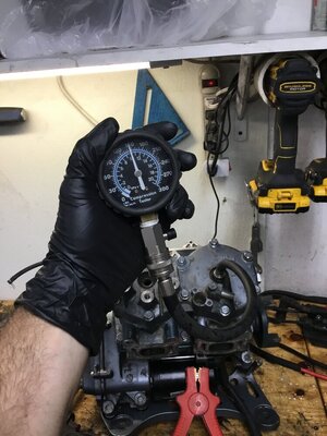

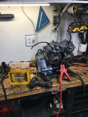

Got my old 650 motor back together and bench compression tested it, was pleasantly surprised to see good compression on it. This old 650 came with my square, in pieces, with the owner reassuring me all it needed was to be put back together. It then sat under my bench for 2 years until I pulled it out, dusted it off, checked it out, and put it back together, true test will be on the water but I'm confident it will work just fine in that old VXR hull for a good beater/buddy/GF ski.
Sketchy bench test

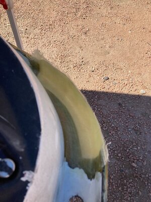

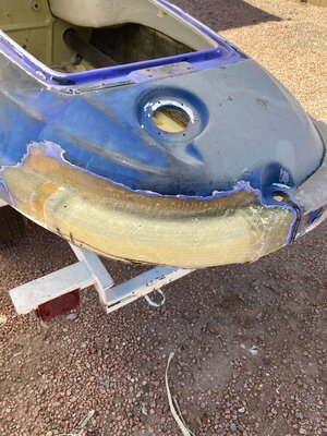

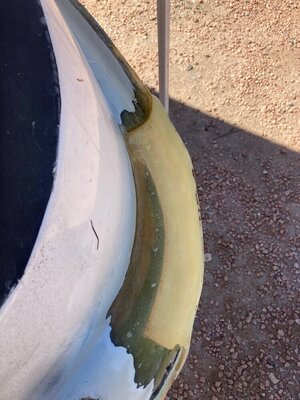

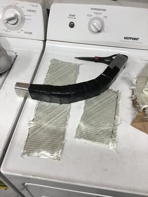

Glass work began this weekend, been a min since I've done this, thankfully I have a good teacher to remind me how its done (thanks Chris @smoofers !).

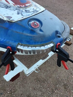

Had some thin tin metal kicking around, so essentially I made a backing plate wrapped in duct tape for a release to get the initial base going on the nose repair, and it worked very well, 4 layers of 17oz biax to start. Trimmed it up a bit, knocked off the blush, flipped the ski over and laid up the back side with 2 more layers and curing as we speak, will likely add a few more on the front side of it then should be good.

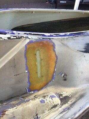

Also deleting the oil level sight hole in the hull, as well as minor repairs here and there, much less work then my square thats for sure! Still, glass work is meditation for me, I enjoy it, very easy/forgiving to work with so it's not a stressful endeavor, just a messy and itchy one.
Crappy pic, too lazy to go out there and re-snap it
