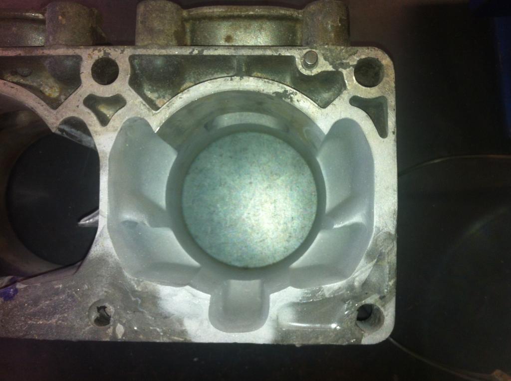

So, I was waiting on parts at one point and decided to finger port a case. I think I made a big mistake. I was going to leave the engine stock except for bolt ons for reliability but had idle time and this is what happens…my question is this: can porting cause an engine to fall on its face around 6000 rpm once it’s hot? I know that I have altered the case volume which will impact vacuum and compression in the entire engine, and now that I think of it would likely cause the pulse signal to not be as crisp. Is that what’s happening? This is a second case that I’ve molested, I’m realizing now that when I ingest water I want it to hit all these surfaces and vaporize before it hits my piston and rings. It’s power vs reliability and since I’m always chasing big air in salt water- the colder the better, I should be prioritizing reliability. So, how bad have I messed this case up? I plan on going back to the stock upper half on my fresh sp today but it has some damage where the FPP limited chamber was rubbing. What are thoughts on this? Any advice? I wish now that I had asked these questions here before getting so far into it.

I have very similarly ported motors that run great, I don't' think you did anything but improve performance with that case porting and trimming the bottom of the sleeve the way you did.
$.02 from a rando on the internet, but with a bit of credibility because I have actually done it very similar to what you did.
Well, I did look around at what others had done before I went at it…That’s not my first attempt. Luckily I had a few cases laying around. I did resolve at one point to leave the engine stock and reliable but….So, the last $200 stock engine ran like a top in till I ingested some water and broke a ring. Im actually looking for that $.02 before it costs me more and lost time on the water.. So thanks!

Your porting is basically what the factory did on sxr800. The carbs must always be retuned whenever any change is made. Open the top screw and leave it on the rich side of peak power. It’s more difficult to melt a piston that way. If it is the 178 degree the exhaust port it can be raised a little without hurting response very much. I wouldn’t go over 2mm. Then make sure the pipe responds quickly, if it doesn’t lower the pump load.
That’s what I thought. I figured it’s probably worth 5hp- but at the risk of throwing cold water right on my pistons. By lowering the ex port 2mm I’d essentially be making it an SXR with thin cylinder walls right? I had this setup pretty dialed and hitting hard with instant throttle response

I was referring to the exhaust open duration. The small pin single carb cylinders were 178 degrees open. The early sitdowns were 178 for single carbs and 184 for twin carbs. Most of the big pin cylinders ran 192. These high ports make great power with a pipe but can also be very slow to respond. Low ports are the most user friendly but make less power. Make sure the sleeve doesn’t rub the crank when mixing various cylinder and crank combos. The SXR stuff is more difficult to find used, I’ve never measured one.
So I finally sat down, got in the right state of mind and thought this through again. It does seem like a fuel problem, fuel pump problem. I thought it would be one of the check valves but the big diaphragm had stretched. To the point that it wasn’t pumping at high rpm once it had been ridden and stretched out a little.
It sounds to me like since my riding style has improved I may want to raise the ports on that next build. Or not. Dammit. I haven't had a good shred sesh in a long time. I gotta get back together so I can go get right!‍
