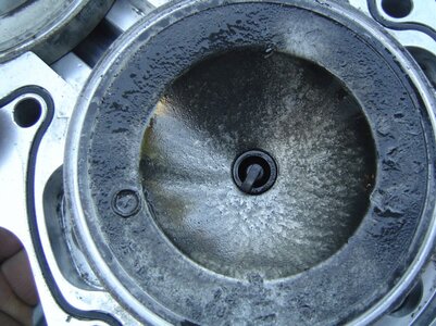

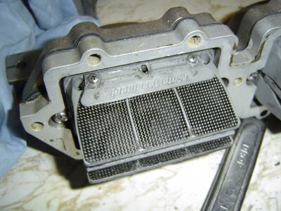

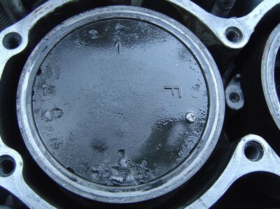

Meh....here's my fine contribution to this subsection of the board.
One of the phillips screws in the VForce reedcages let go.
Pisses me off.
Anyone got 83.25mm pistons for me? :woot: :bs2:

Ive always worried about that... not V-force, but any reeds.
I dont guess loctite and nylon fasteners would hold huh?

Hey didnt you have a set of spare pistons??:sneaky:
Didnt you just take apart your reeds??
Call me and maybe I can help some......

I feel for you Matt! That is pretty wild looking! What are the odds of that screw to end in the perfect position to be pressed into the piston and the dome? How did the cylinder fair.will it take a hone or will you have to bore?
Matt_E
steals hub caps from cars
at peace
I thought I could get away with a bore.
Unfortunately, the sleeve has a chunk missing now.
So, I'm probaly looking at a new topend.

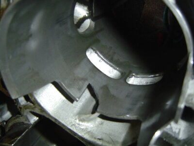

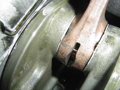

More pics of the carnage.
See the sleeve. :rolleyes: And the screw that caused all the trouble. Well, the open hole for it, anyhow.
Also, notice the thrustwasher on the crank. Is that a problem? It spins freely. Seems the damage is cosmetic.
Opinions?

Don't know. :frown:
I suspect it went out the top too. I am going to split the cases to find out for sure.
