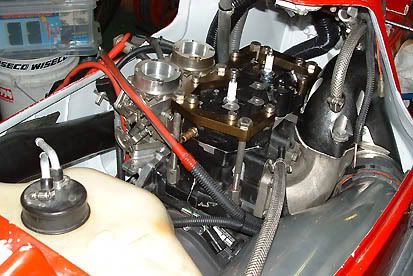

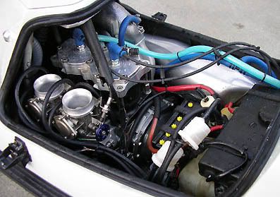

No Really I want to know,I know why I put the Rotax in mine,I had everything here,it didn't cost me anything and the whole thing is totally reversible if I decide to go back with a Kawi setup later.I also have all the mod parts for that engine and the I know how to tune it.85hp in stock form is a good place to start from IMO.Now what are the positives to plugging in a Yami engine into that boat especially a 701? A 760 now that would make somewhat more sense to me,a 701 I just don't get,plus if you do mod it for a 701,its not easily reversable and you still have to spend quite a few dollars on parts to make enough power to be any fun.

A) the kawasaki 650 motor SUCKS
B) the yamaha motor has much better out of the box power than almost all of kawasakis motors
C) performance parts for the yamaha are EVERYWHERE used and new
D) they make much better power with the same parts/work and displacement than the kawasaki engines

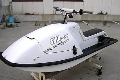

E) ask the japanese, they are doing it in their freestyle X2's there must be some reason
just like the thread says, more bang for your buck especially in a freestyle app. a 701 is way better with bolt ons than a 650/750 and respond much better to mods
do this, ride a kawasaki 650sx with a pipe, then ride a 650 superjet with a pipe, then ride a kawasaki 750 with a pipe, the ride at 701 or 760 with a pipe which is better?
