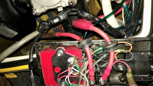

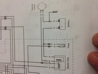

I'm trying to wire in my new Yamaha relay but I don't know which starter cable goes to which post. Looking at diagram in the manual, it looks like post closest to brown wire goes to negative and post closest to black wire goes to positive. Both starter cables are red so I presume the one fused is the hot but am I correct with the statement that the post closest to brown is for negative starter cable?
I took everything out of my electrical box to clean it up but didn't take enough pictures and I have no recollection.

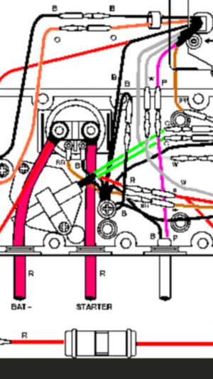

2 fat red cables go to the starter relay, one red 12V b+ from battery the other red to starter b+ post....
Like this photo.. never mind the b- in photo

When you say left vs right are you looking at ebox from nose of ski? I think I'm going to reverse from how I have it now. Looking from nose of ski the right post is going to battery and left is going to starter which seems backwards as I'm thinking the post closest to the starter should go to the starter.
Attached is what I did. Look correct? Pic from nose of ski. Left post wire is going to battery.

The Starter solenoid is a giant switch with a single contact inside, there is no polarity so it doesn't matter which post they go to.
The smaller brown and black wires matter but I believe you have that part figured already. ;)
