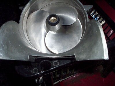

Just got mine back from Robert at Jetskimechanic.com, it took forever from skat, as they are swamped and are slow with custom orders. Can't wait to get it out and try it, i'm sitting about 7mm from the stator veins.
FYI, thats a 12/17 with an 85mm exit nozzle and short pump cone. With my 650 limited setup it loaded the pump slightly more that I like, but with the mod 750 thats going in it should be perfect.
