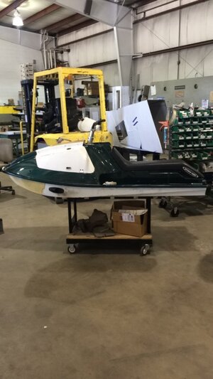

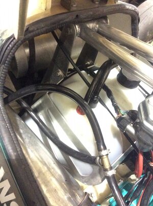

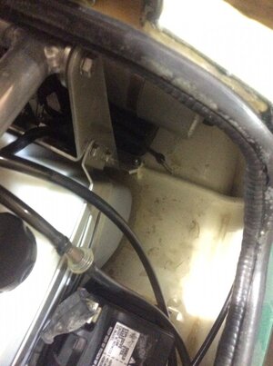

IMG_3711.JPG IMG_0094.JPG IMG_0093.JPG Im currently building my x2. It started out with a hot 650 that lasted 2 seasons, did a full rebuild and had the crank break after 3 hours and wreck everything. I switched to a super clean 750 big pin and have plans to wake it up on the bottom a little. I know it will never be as snappy as the 650 but this motor was cheap. I built a custom tank mount for a 2 gallon tank, shaved hood, a ton a hull repairs, and a bit more small custom stuff. Just looking for some input if its worth waking this up or putting it in my other x2 for a race ski and building a 701/760 for a freeride/play ride ski

I dont think the 750 is more or less powerful than the 650 on the bottom, but certainky so on the mid and top. This is depended on the pipe. My 750bp with44s and b-pipe is massivelymore powerful than my buddys 750sp with 650 am pipe and a single 44, but only in the mid and top really.
None of the kawis ive riddenhit likemy superjet including sxr 800 with b-pipe. It could be factors of weight and wetted surface but i think the yamaha hits sooner and winds out earlier. Ive never ridden a 701 kawi so i cant comment on that, bjt the superjet motor and b-pipe fit better in the x2 than the kawi does with the bpipe.
Thanks! All very good information. I figured with the time and money spent to get the 750 to hit harder it would make more sense to find a 701 and b-pipe. I feel like my stock superjet revs faster and pulls harder off bottom than the 750 with 180 psi compression too but you can really feel the 750 come on mid to top

The kawi will make the power, but prop it to hit hard sooner means it can wind too high. Depends on your goal. If you want a multipurpose x2 the yamaha is a good compromise. The surf riders do the same thing to the yamahas, that is prop them to blow up if you race them. You can always start with a kawi and prop it real low (I don't know what prop you would need). Let the kawi into the midrange sooner and it'll pull hard.
Again, I haven't but ridden a 701 x2. I have rode a 10second kawi it it was okay. I want to be able to run bouys too though so a 10 second ski isn't for me
I did some more research and it sounds like a dynafly 12/21 works real well with the 750 for the bottom end hit. I'll keep researching and call Impros and see what they think also
