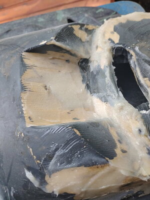

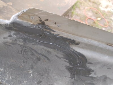

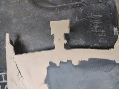

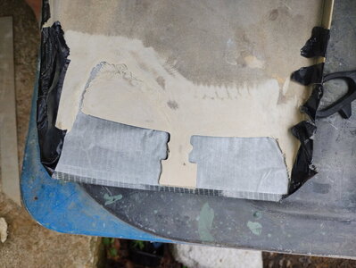

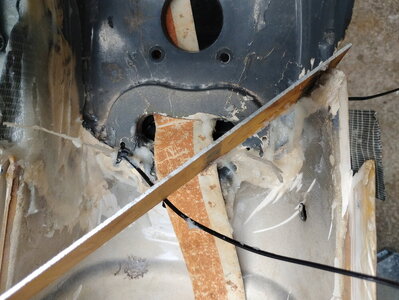

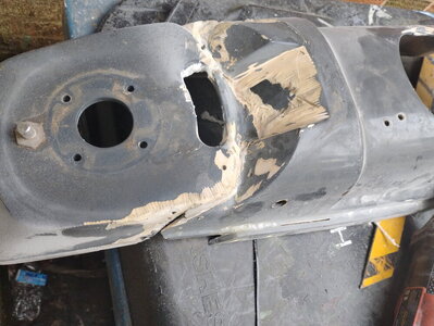

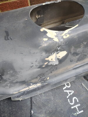

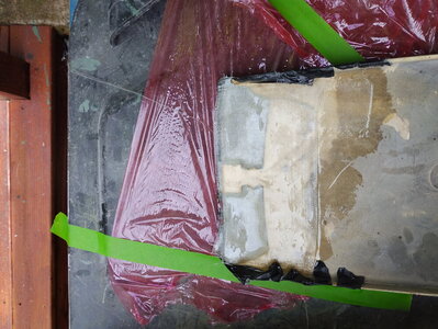

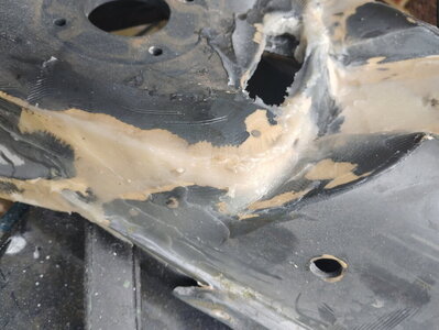

Southern word of the day is Sensuous , Since- you- was grinding and laying up glass anyway I ground down the inside of the handlepole crack on both sides and laid up two layers of fiberglass tape and epoxy on the inside .

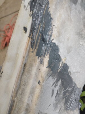

Notice that the only JB weld left is what was in the crack itself , The JB Weld was just there to hold everything together till I could glass it up ,
it's ground all the way down to SMC , Metton or whatever this crap is called.
Still getting rained out here , about as soon as I finished laying this up a thunderstorm popped up and I had to move everything .
