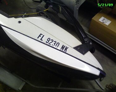

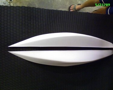

I have a set made for the fx1 hull. pics suck cause of the black bottom.

you can also glass them in for an extra measure of permanent bonding. I use 5200 or some thickened epoxy to install them. they should fit nearly perfect to the hull and not require a lot of extra hassle to install.
I have tubbie II's on mine. Never rode it stock for a comparison. Wish they went farther forward(up to the nose of the hull) like the ones Tom21 is making. It would look a lot cleaner installed.
