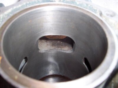

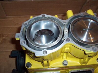

I've ported two engines with those templates and they both make really good power. One 750 and one 61x. The 61x port job was more impressive though. If you've got the tools to do it yourself, get some good grinding bits and knock it out. Cost me $100 shipped for each template and a few hours of my time.
I'll point out a couple things that are obvious to some and then obvious to everyone else once it's been pointed out. When you mark up the cylinder with your cut lines, you can't just cut the sleeve and lightly touch the inside of the port itself to help smooth it out. You really have to attack the inside of the port as well if you want it to work.
