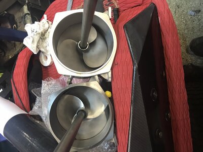

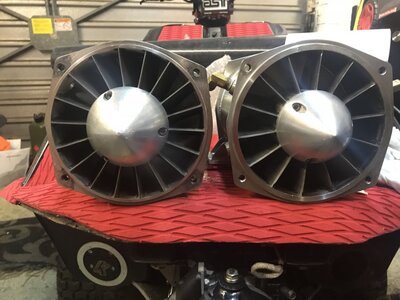

Have a 2015 new shape XFS comp with dasa 1200 and RRP pipe.
Had a max 155 75mm 14 vane with a 9/15 skat thin blade pitched to a 13/19.
Worked really well, not huge bottom but pulls really hard in the mid range on combos.
Got a Maxx 160 18 vane 83mm hub with a 12/19 thin balde, long blade skat. Pump was so tight, crazy almost un rideable bottom but lacked the combo power.
Pitched it down to a 11/17 and it’s pretty bloody good, not convinced it’s that much better if any than the 155.
What’s everyone’s else’s experience with this? In two minds to change back to the 155 or if I should keep working on the 160. Should it perform better than the 155 once dialled in.
Cheers
