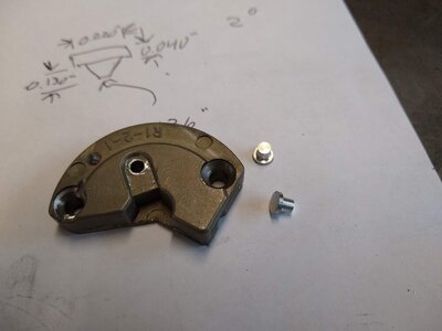

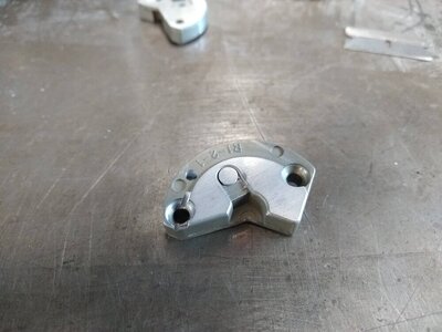

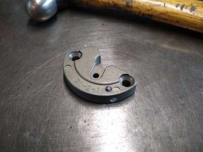

If understood correctly, I need to drill the new passage (red line), make a new hole from the top part, and block the middle top hole above the check valve (but not to cover the inside passage).
What about the existing passage at the bottom, which is blocked from the side
(blue line )? Can be left as it is?
Am I missing something?
