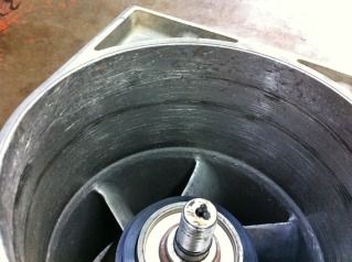

Like the title says, I have a 750sxi pro and the wear ring is getting pretty gouged up. The gap between the impeller and ring is a bit wide and was thinking about having the ring replaced but dont know where to have it done or if its better to buy a new one and press it in myself. I would just ditch it and get a pump but I spent waaaay too much time blueprinting it last year. Any suggestions?
Yea, it "looks" like the wear is on the ring. I did some digging and found clearence specs for other models and measured mine. Im at .016 so I think its ok for now. I'll just clean it up and have the impeller re-worked by impros. I had to do a quick straightening job with pliers and a file a few weeks ago. Too close to the end of season to send it off then.
