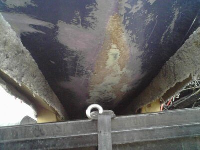

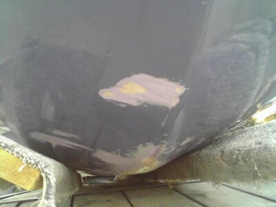

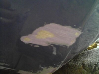

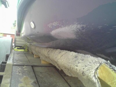

Stan, keep in mind that SJ's have an SMC bottom deck, which is impervious to delamination.
AFAIK, Seadoos have laminated Glass hulls. Exposed glass can lead to delamination, especially on the bottom.
It should get fixed, with gelcoat.

Here's the pics of all the damage the storm did. :crutches:
It doesn't look as bad as I thought.
I'm only worried about the crap on bottom. As far as I can tell it didn't cut into the fiberglass at all.
Any opinions on the damage is welcome. :veryhappy:
