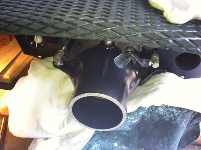

I'm running a SXR based Q8 Sky and I'n in need of some more throw. Any advice is appreciated. I would prefer to just buy a nozzle though.

IMG_0683.jpgi am running a pro-tec i believe +20mm i think it works great ! the little issues i encountered being :#1 be sure and locktite pivot bolts #2 a little more slop on pivot bolts than stock.pro-tec are great to deal with . i would call them to inquire about your application as mine is on my trim system
