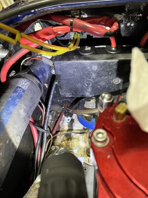

My ski is a 96 SJ701. I am sorry that I do not know about it better than i do. Most of what I know about jet skis I have learned reading here, so all help is appreciated.
The picture is of the back right lower corner of the engine compartment. What is the thing with the large washer and wing nut bolted on there, and what is it for?
Also, the space under the tray seems to take on water with use and I have been trying to figure out where from, and if possible seal any candidates as best i can without cutting the tray open. The red steering cable goes into the tube just beside the thing I asked about above. At the other (jet) end where the cable exits the tray compartment far wall it is sealed with the standard gland fitting, but on the engine compartment end the tube seems open. I am wondering if maybe that tube is cracked in the tray compartment and maybe sometimes leaking water coming from the engine compartment. Would there be any concerns with trying to seal the engine compartment side of that tube opening by putting silicone all around the where the cable goes in?
