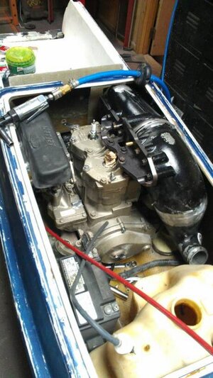

I cut the pipe in half and rotated it and then I had to move my tray back 1 inch to get it to fit in my fx1

My issue I think is on the Red circled areas (using your pictures)
I think It has enough space from the tray. But not the lip. How much material did you remove from the pipe in the red areas to get it to fit?
And is the FX1 engine bay smaller then the square nose bay?
Ill break out the grinder if shaving the pipe is an option

I'm pretty sure it is smaller but I ground down the cast mark on the back of pipe and ground down the hull. On the side of the engine bay I had to cut a groove big enough for the clam to fit and it all goes in with a little bit of wiggling

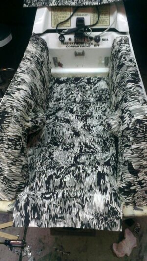

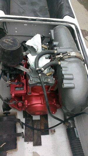

I am running the same setup... I had no issues back by the fire wall... i mean it is CLOSEbut not hitting, as for the area by the clamp, yes i took my sawzall an notched out a bit of fiberglass... MAKE SURE your water line is hooked up to your manifold BEOFRE installing the whole pipe. you will NOT be able to get the hose on let alone a clamp. And if your pisser is back in that area too like mine is, attach the hose to that before the exhaust install as well. They say that a B-pipe will ad 12 HP to the 701 or something... well after switching from this hevy biatch it will be like adding 25 hp, lol.313765_491075720928121_823778146_n.jpg

oh thats right and the ebox... i do not have any pics from the inside for you, but i moved my brackets... IT IS a TIGHT fit for this monster of an exhaust...
Ok, so can you see where the mounting holes use to be? do you know how the brakets are shaped? (i'm going to try to make this make sense) the left side i moved over and have it mounted behind the exhaust, the bolt for the ebox is over far JUST far enough for the ebox to be able to come on and off the mounting bolt. Then on the riht side, i again had to move where the braket attache to the firewall, nd again have the bolt for the ebox to the right of mounting holes for teh braket. This side attaches a bit close to the exhaust outlet hose. make sense???

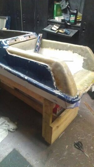

Im not sure about drilking holes unless its last ditch. As I have no resin to plug them with. But I did just install a bilge.
I wonder if unbolting the mount and flipping them both facing to the right side would work. It don't look like I need to much more room

lol believe me i tried everything before having to drill holes... just use some caulk to plug it for now... or stop by your local auto store and pick up a small tube of 5 min epoxy.

Tape off the holes in the engine bay and fill the holes outside with jb weld. You will be good
