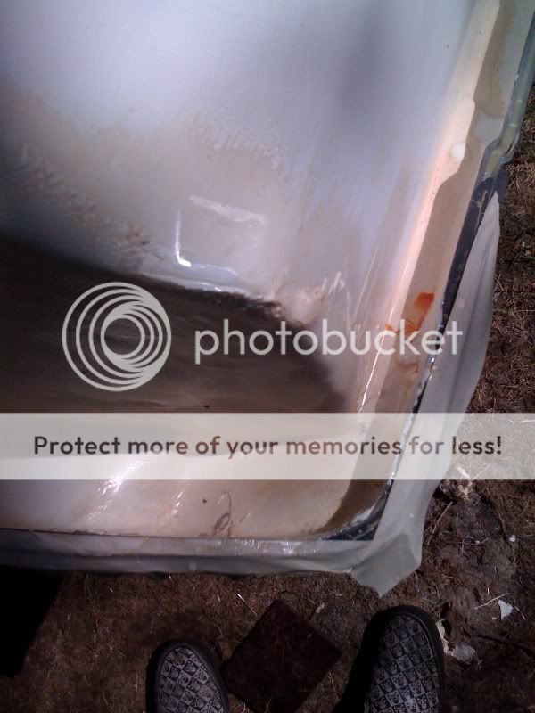

Other weird orange color liquid after epoxy cures????

i cant figure this out so i figured i ask. what the heck is this orange/rust color that came out of my west system epoxy?
(beefin up the rear lip and some of the transom)

Its called blushing and it has to do with moisture in the air and the chemicals in the epoxy- and since you appear to be outside, it could be darker because of pollen.

It is called "blushing".
It is usually the cheaper epoxies that blush. When some epoxies harden, a byproduct of the curing reaction rises to the surface appearing as a greasy, waxy layer. It's due to moisture in the air during cure.
Sand it off before any kind of painting, etc, or it will not stick.
