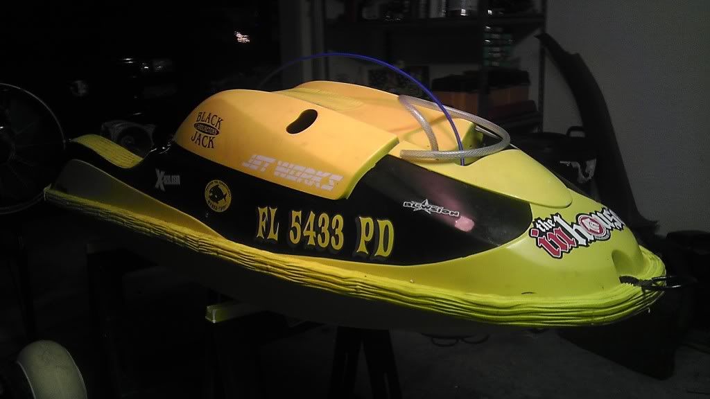

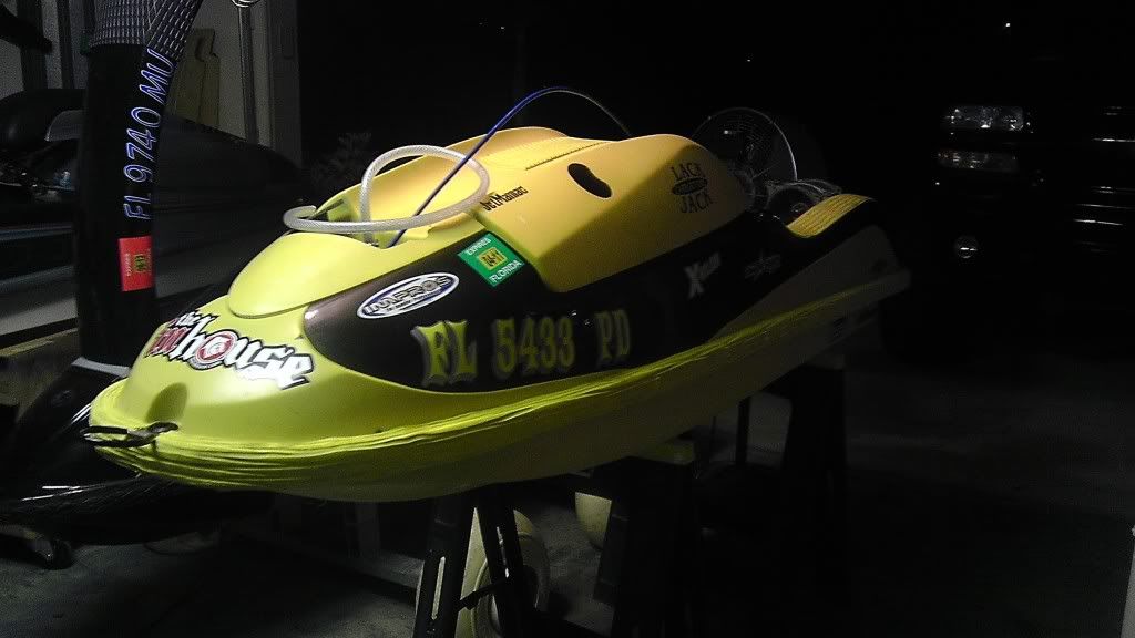

picked up a project hull from Matth113 this will be my first yami based ski

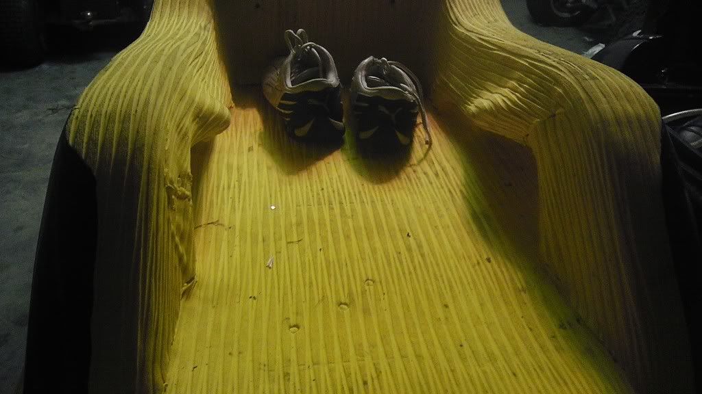

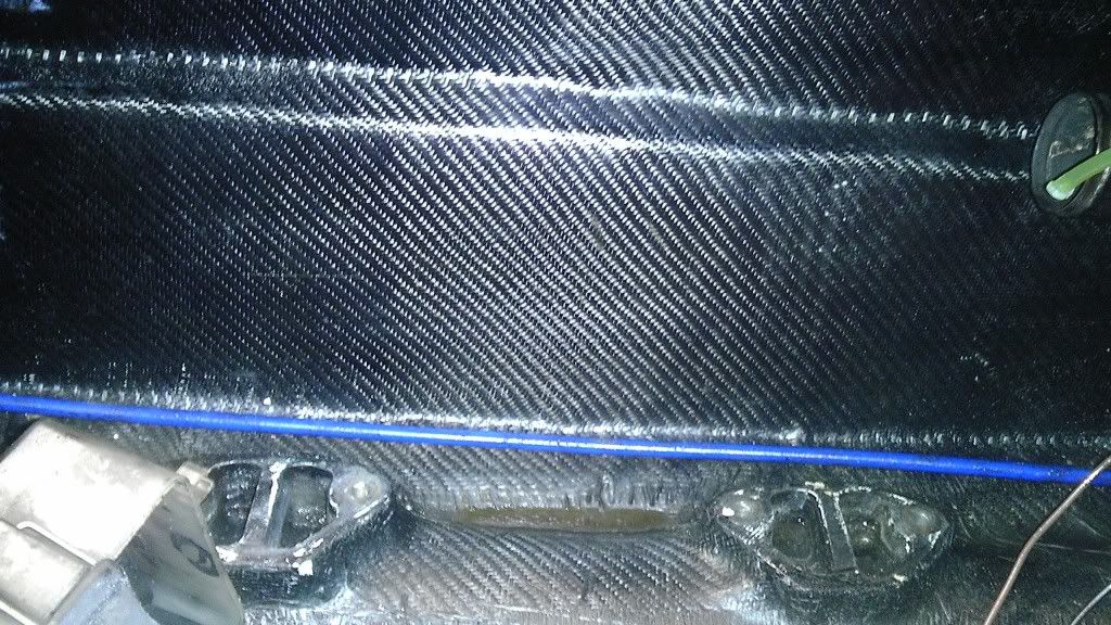

What it is

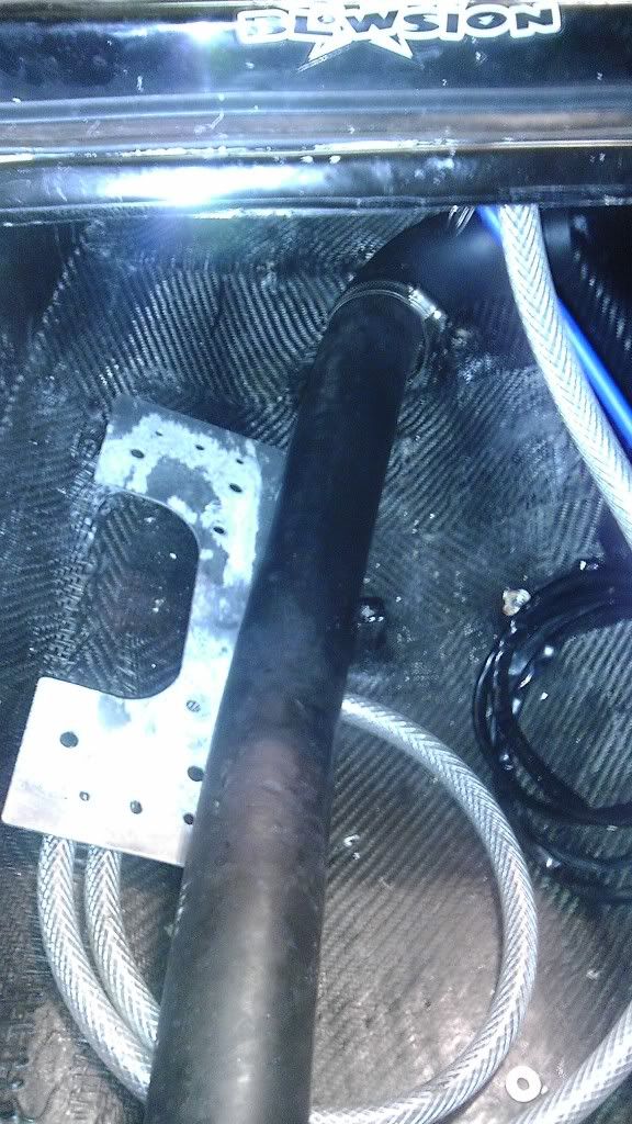

Square nose lower hull that has been shortened 3" and the nose has been remolded to match a round nose. the top deck is WCF top deck, hood and nose piece. the other mods on the hull is it has been completely reinforced with carbon fiber, foot holds, dual 1100 gph bilge pumps, and is piped out for dual cooling and trim system.
Current plans
Limited 701 engine
MSD enhancer
MSD coil
stock electrical box
havent decide on carb set up yet
factory b pipe
carbon fiber mod b chamber (i am going to make it myself off a plug from my friends pipe)
Carbon fiber (again making it myself)

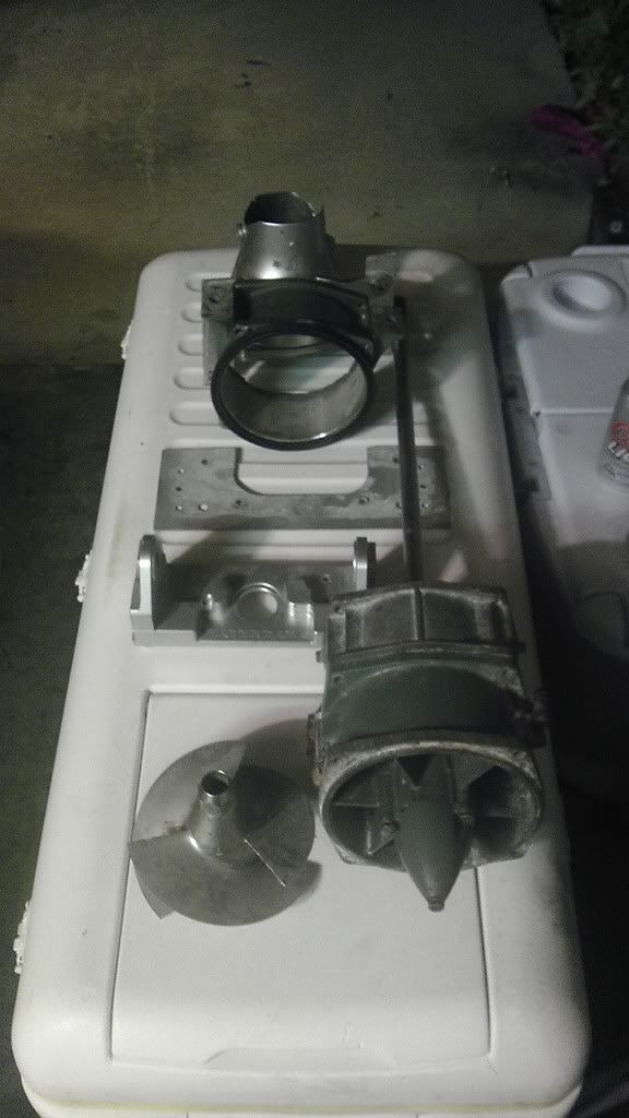

3" set back 144mm pump (no trim for now)
stock handpole that i am going to shorten and cf reinforce
Future plans
Paint
returf
trim
800 motor
mag pump

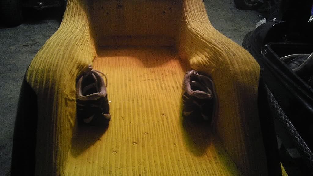

adjustable food holds
the tray not in love with the holds but they fit my riding shoes

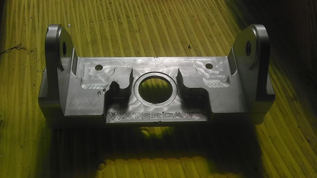

first bit of parts coming in set back pump, skat trak, impellar, drive shaft, reinfocing plate for the pole, and a billet waterdawg customs lowered pole mounting bracket
billet porn
