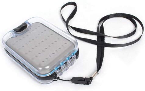

Working on a custom little electronics thing that I need to keep dry inside my jetski. Ideally I need a 3" x 3" x 1" IP68 clear box. The closest I have found is a small Fly Box that's 4" x 3" x 1.5".
https://www.amazon.com/gp/product/B081VCDJGY/ref=ppx_yo_dt_b_asin_title_o01_s00?ie=UTF8&psc=1
Also need to run 4 small gauge wires out of the box, trying to figure out the best solution for a waterproof bulkhead fitting on that small of a space.
Any ideas or thoughts are appreciated!

Ooo that would do the trick, wasn't able to find anything quite that small stateside. Working on a external BMS, so if my AG drops below 11v I cant over discharge it.
okai, if its just a BMS system, you might be able to just "pot" that ? with potting compound or epoxy resin? Unles you need to be able to open it.
Potting is an option i've considered, there is a display and some buttons for input, but once its set I shouldn't need to touch it again, clear epoxy so that you can read the display could be very doable and bulletproof.
