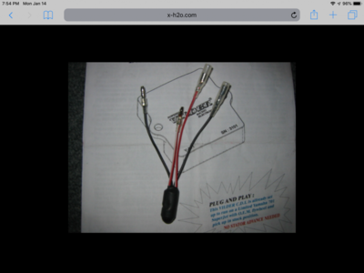

Also Vilder released a filter, believe it’s a diode?, to prevent spikes that caused cdi failures

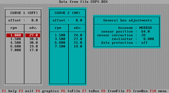

I opened an XP Pro VM on my Win10 laptop, copied the Vilder files to the desktop and it opened right up.
I would need an ignition module to take this any further but it's possible.
The real trick will be training guys to use a Virtual Machine. :)
The software I use is VMWare Worksation (free version).
Here is it running on an XP Pro VM which is no different than running an actual XP PC. I tried it on a Win7 build and it wouldn't run so Win XP looks to be the latest version that will still run the software.

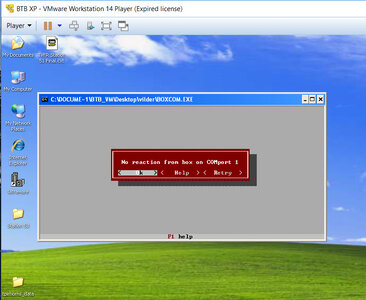

I had to bail on the WIN10 PC and VMware for now and at least get it working on an older PC first. You can run the software from Win XP but it never finds a COM port with which to communicate to the CDI with.
The instructions say to use a DOS Boot disk which works exactly as the instructions describe.
It’s never a good day when I have to break out the floppy drive.
However, I am happy to report that I am online with one of the purple ones.
Purple Unit Type:011 #2130
Not having much luck with the Red box or the second purple unit.
The second purple model is telling me it is not comparable with the software version I’m running.
