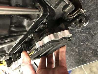

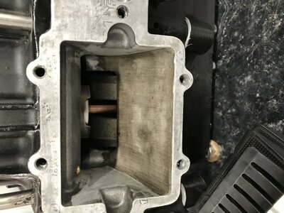

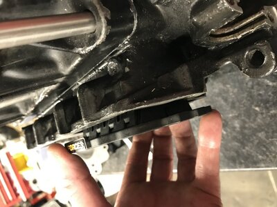

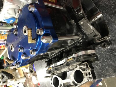

Just building a 62t 760 for a friend. Cases have been heavily ported including the inlet tracks being filled too.
He gave a me a set of Vforce 3 reeds to fit for him.
If I don’t run a reed spacer they hit the epoxy. Run a spacer and just clear.
Never seen anyone run these with a reed spacer, will it still be worth it or just go back to the stock cages and carbon tec reeds.
