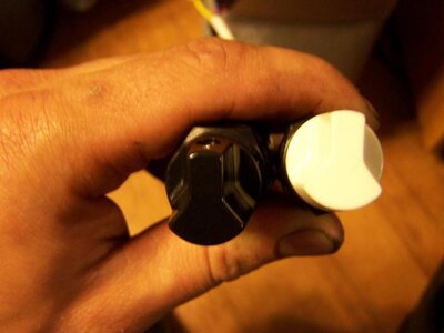

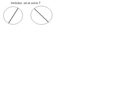

Hey im am intalling a cdi-9r ignition as we speak, & the blowsion instructions blow. for the switches which is the top of the switch. is it the skinny part Or the fat part. i Need to run curve 7. top of the switches need to be pointing towards each other as per the switch position diagram.
Please help soon as possible. i want to go ride tomorrow
Thank you.

Any luck with CDI-9R settings? I too just purchased a CDI-9R from Blowsion and was very disappointed with the instructions for setting the switches.
I am running curve 5, but would like to try other curves if it will not damage my motor with pump 93 gas.
From the insructions, it looks to me for curve 7 (with both switches starting all the way to the left) the black switch would be over one click to the right and the white switch would be over two clicks to the right.
S/W 1 = black
S/W 2 = white
Please let me know if you have any luck and if you are running pump gas.
Good luck!
Eric

Skinny part is top, yours looks right to me.
I don't have my crib notes in front of me, but from what I posted on PWC today on this matter:
"Call blowsion, there are different set ups for each type of ski set up. You will probably be with curve 7 I think. It was shown on the front of the CDi box. Black knob to the right, White one to the left viewed from the front and knobs up. Hope that helps. Make sure your carbs are readjusted and jetted or you will be to lean!!!"
