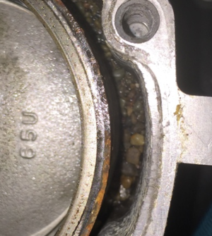

Yes... I had taken everything apart including hooking up the garden hose to the head pipe. Water did come out, but on continued further inspection there was a rock stuck in the bottom 90 degree fitting. Lesson learned.
Step one remove all brass fittings and visually inspect. Apparently garden hose water can still get by and fool you into thinking all is well.
Ski has been running great all summer and the other day the pisser that comes from the barb on top of B-pipe stops throwing water overboard.
So I started with the usual diagnosis process. Disconnected dual cooling at pump and checked both brass 90s, hooked hose up to rear cooling lines and blew water up into hull (I have quick disconnects installed just inside the hull for easy engine removal), pulled the B-pipe and hooked it up to hose, the chamber filled up with water and it shot out the top barb as it should and also came out the bottom screw hole which I have open 3/4 of a turn, I pulled the head and there was some gravel around the rear cylinder (flipped the ski upside down blew it out with compressed air).
