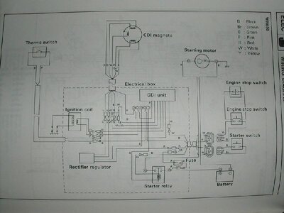

Guys, that fuse protects the entire ski's electrical system. That includes the wiring going to the start/stop buttons too. I'd rather pop a fuse than catch my wiring on fire.
