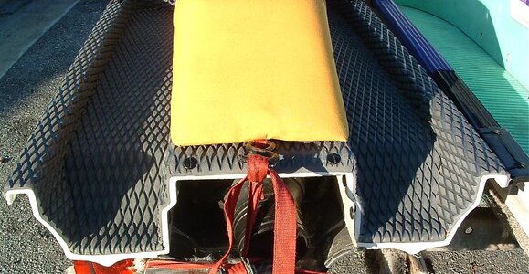

I want to turf the bond line, but have seen cases where it fails very quickly and comes off. Should it wrap up and under, or just be glued and trimmed off. Any suggestions would be helpfull.
glued and trimmed off. trim at an upward angle as to not let the water have a large surface to bite on

cut the turf at a 45 deg angle. I use a silicone all the way around the edge. Not the rubber silicone, but the thin stuff that dries hard. Once you cut it, you can also sand it for a really smooth edge.
