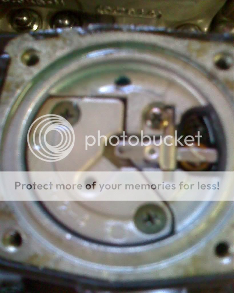

ok im trying to installed the jet screw inside the carbs that came with my wet pipe i cant seem to see where they go here is a picture

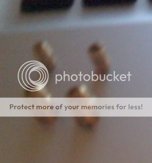

these are the screw there are four: 2 are fat and 2 and smaller

please reply back need the help
st.pete
those two screws to the left and that plate will come of there will be to jets in there put some oil or something befor you try to break lose dont break them or lose any parts and put back the way you started
