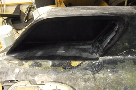

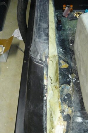

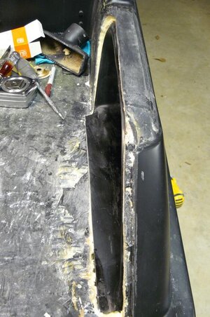

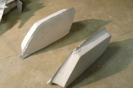

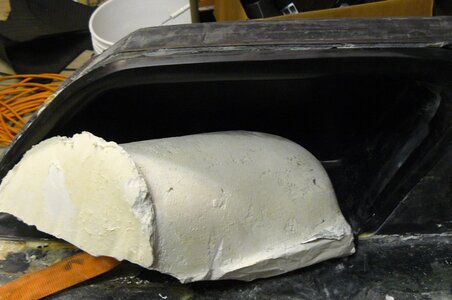

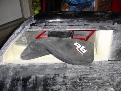

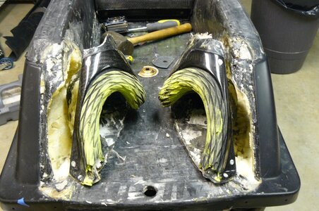

There is no way to install the holds according to the instructions . The boxes that bond to the inside of the gunwales are not deep enough . By my measurements they are about 1/2 inch to shallow. IMO that is way to much to shim. A proper bond / alignment MUST be made from the box to the inside of the gunwale for structural support .

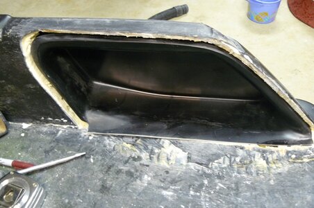

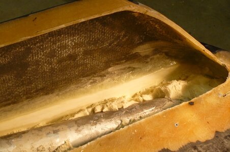

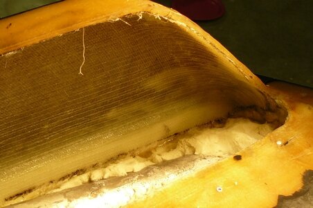

The 4 pic is how they should fit , but even with the gunwale trimmed back as far as I have trimmed it . The boxes are to shallow. it should be noted that the instructions do not advise cutting as much of the rear gunwale away as I have. The xfts were already cut that much so I worked with what I had .
It's very workable I'm just disappointed in the lack of accuracy with the box dimissiosnins . This would be a one or two day install ( for a guy with out a , wife , kids , job , and a religious affiliation on sundays , but will turn in to much more . I expect more from RRP . They build top shelf components , but missed the mark on this one . Is High Roller working for them now ............. I kid ........ I'm a kidder .
