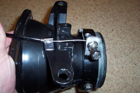

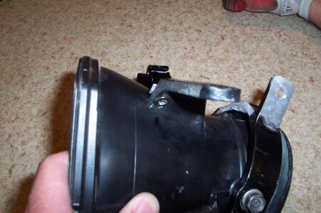

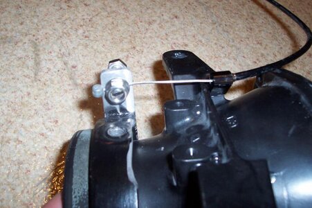

I bought the black tab I mounted behind the trim ring from Protec. Then I just cut a slit in the bolt. I think that piece is like $7.

It's crooked in the picture because I was holding a bike cable in there with one hand. I also used the protec cable and it fits in there very well. The angle from that holder to the trim tube has only a slight bend to it and nothing compared to any of the angles that it sees in the engine bay. This trim is incredibly easy to pull.

I'm actually not relying on the pinch from the nut as much as the ball from cable. The nut is fairly loose with loctite on it.
