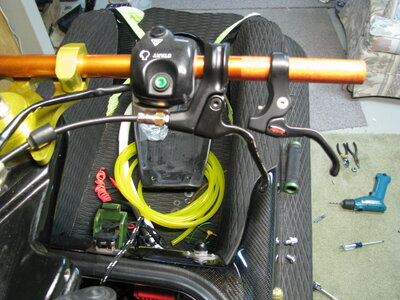

This is a 12 dollar mountain bike lever. I have more trim now. More ingredients to BF. less excuses not to!
Did you have someone anodize your turn plate and bars or did you purchase them that way?
Those Avid levers were the best that I could find with the most cable pull.
I only have to adjust the fulcrum point about half way for maximum throw and they have an adjustable lever height for easy reach.
