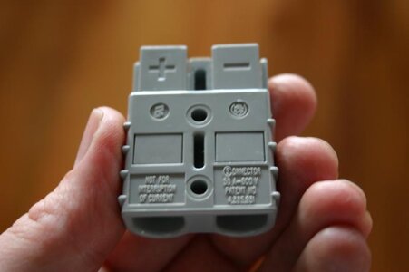

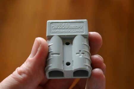

Anyone with a TL using quick-connect/disconnects for the batt? I've only had my TL up and running about a month or so and I'm already tired of the disconnect process. I've got about 5 leads to each terminal. I've thought about consolidating them on one or two round eye leads for each terminal. I can't remember, Jetworks or JSS said they don't like them, but I'm not riding in surf and can't see why not to use them.
Second question...how do I get 'em hooked up. Plan is to run a fat guage wire from each batt post with the actual leads on those 2 wires and have the harness with all the ski wires remain in the boat. I can't figure where in the he** these wires will connect!! The batt terms are no prob. You plug your connectors in the fluted end (two barrels). The opposite end is where you lift up the latch/disconnect tab to release the leads. The underside shows 2 squares that look like they come out, but I can't get them out without tearing up the thing ($15.00).
I may end up going to 2 large, insulated bullet type conectors or something of that variety that allows me a quicker/easier access to the batt. Any suggestions are welcome.

I park it on a lift on my dock and would have to leave the charger set outside with an extension cord to charge it. I'd love to be able to charge it in the ski. I got those quick connects from Mcdog. I think he got them from Jetworks. They don't sell them on their website anymore, but he sold Mcdog a couple they had back in the shop. Call Art @ jetworks and see what's up.

they are $10 each from mcmaster carr
7043K22
or $6 EACH for the 50 amp version, which I bet would work just fine. ( its the one in the photo at the top of this thread) avalb in black, blue, grey or red
7043K21
7043K22
7043K21

Anybody know how best to install these? I'm open to all suggestions. I've got two sets.

if you read the mcmaster car link, it tells you the amperage ratings are based on the guage of wire the connector will fit, and basically nothing else.
DO what you want, spend your money where you want.
im saying those connectors rated at 50 amps, will crank your ski.
regardless of what you have ' blown past ' before.
think of it this way, a connector rated at 50 A continuous would likely do 200 amps for the 2 seconds you are holding the switch down.
LOOK at the connectors, the conducting lugs are LARGER than the starter cable that comes on your ski.
