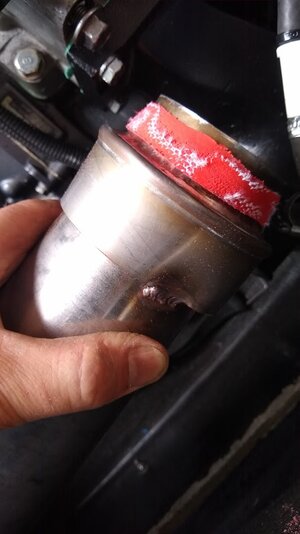

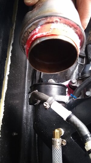

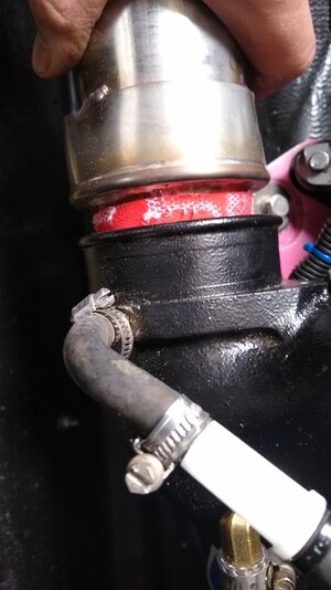

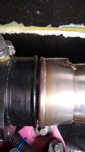

I got this idea from @Roseand but couldn't find the thread he posted in so I started a new one. Tim at tnt recommends using RTV around the mating surfaces which sucks if you need to remove the exhaust want to get back on the water right away. So hopefully next best thing to orings. This also gives it a very snug fit and no metal to metal contact.

1 tank of gas through her and so far so good. I will put a few more tanks through and then maybe I will pull it apart and check it.
Anyone know here you can get 2.5" 1 ply silicone hose? :)
