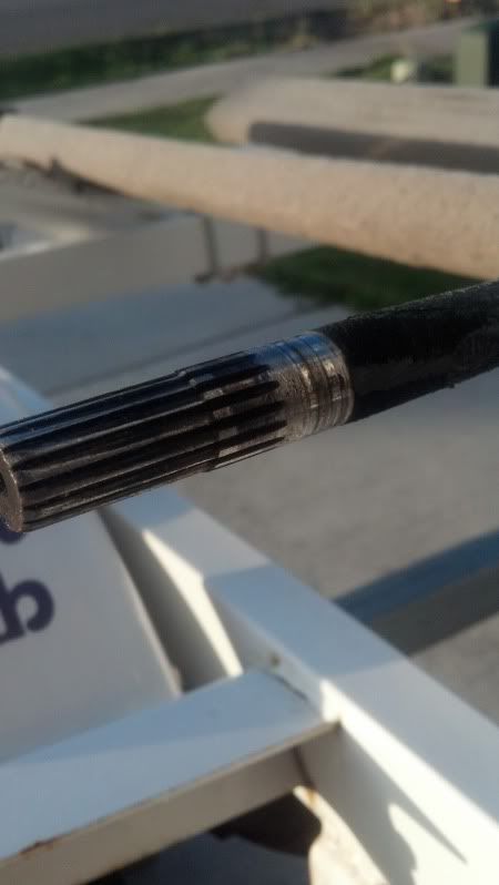

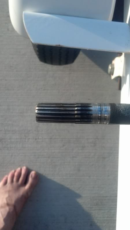

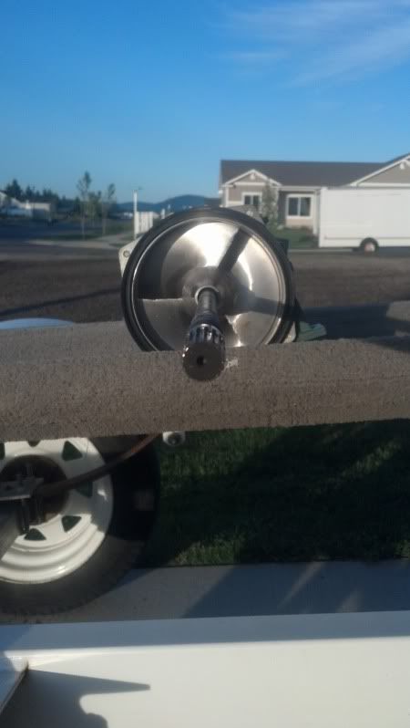

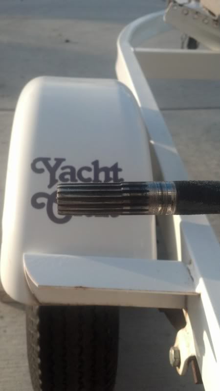

Heres some pics of the drive shaft splines. They look a little funky to me but I have never seen any up close before to know if they should look like this. Whats the verdict?
DarkWater
Down Side Up
waterford, MI
That is stripped my friend.
Here is a good shaft next to a stripped
The splines should be even all the way, not 2 stage like our stripper here.
