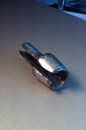

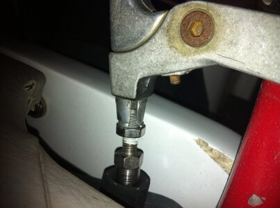

Hey guys, at the end of one of my last rides I did a nose stab, came up and my ski took off. I had one hand on the bars, pulled my self up and ran back to the launch and pulled my lanyard. What happened was the last 5 threads behind the adjusting nut (inside the throttle lever, you can see the extra threads through the slot on that nipple) had pulled out away from the lever and got stuck on the outter edge of that nipple thing. seems like it would give slack on the throttle cable but it reved the motor up almost 3/4 of the way until I pushed the threads back in the lever, and the nut was flush with the lever.
So, I guess I am wondering if I am missing a part, causing this to happen, or if there is a good way to make sure this will not happen again.
