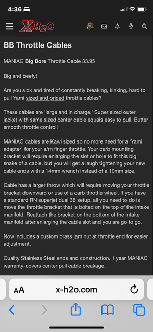

I just installed a push ind intake manifold in my tigercraft v2. The ski has a 10mm throttle cable already installed but it is worn a bit and the intake manifold only accepts 6mm. Should I replace the throttle cable with 6mm - replacing the lever as well? Are stock SJ cables too long for AM hulls? Or is there an adapter out there to make my configuration work as is?
