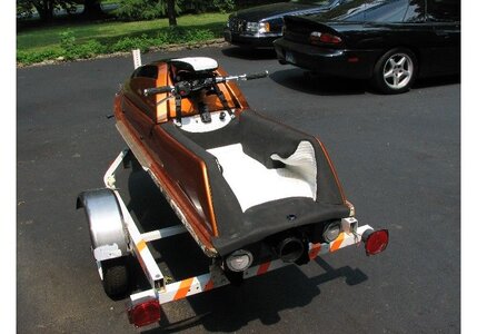

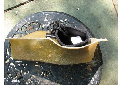

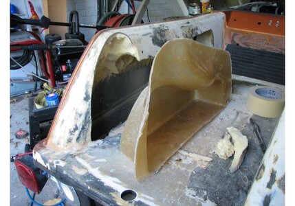

I cut and ground the foothold itself down untill they sat all the way into the ski. The outside of the foot hold is the out side of the ski. If you went any wider your foot would be outside the ski. But I only moved the foothold 1/4 of an inch out maybe at the most. The middle of the foothold at the ankle is is cut all the way out to the painted part of the ski.
Look at this picture it will show how far they are spaced out. This is compared to a 24-7 generation one foothold
