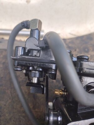

Notice the cheap wire fuel line clamps in the 1st photo , yeah Mikuni does not use those they use Oitker clamps with a proper fit on the hose , you can see the difference the 2nd pic . So far externally that's the best way to tell them apart , I would need a stocker in hand to look at the Mikuni casting stamp and I will have that as soon as he brings me another crab Monday , then I can compare them side by side .

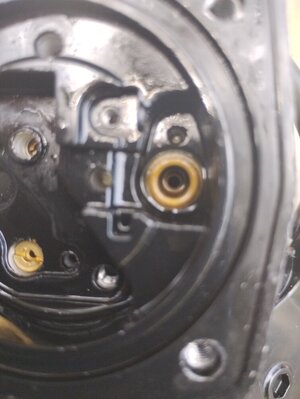

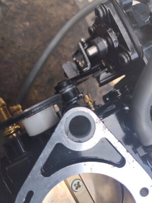

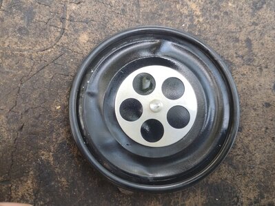

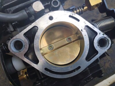

Autopsy time : Here is what I found
1st pic , notice the black paint in the recesses of the carb throttle plate is stamped 120
2nd pic , misalignment on the accell pump lever to the wheel that actuates it
3rd and 4th pics , this shows the travel on the accell pump diaphragm rod , it's not much , notice it also looks bent slightly
5th pic , inside of the carb, black paint, I wonder how long that will last before it start flaking off ?
6th pic , main diaphragm , it looks halfway decent , notice no red tip on the button , all Mikuni diaphragms have a red anodized tip there
7th pic , jet cover , it looks ok but the reed, valve whatever you like to call it is white and possibly the wrong thickness , hard to determine
continued next post :

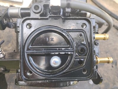

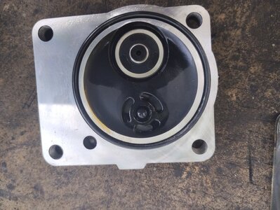

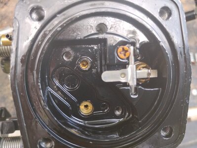

1st pic , jet cover screws , very thin cheap BS , not stainless
2nd pic, behind the jet cover , nothing exciting to see here
3rd pic , now this one is really nice , the horseshoe and screw that hold in the seat , yeah it's not even there m nice , really nice

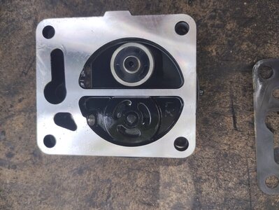

4th pic ,inside the fuel pump , nothing drastic but the plastic diaphragm isn't sealed to the gasket at all
5th and 6th pic , pump assy , actually looks fairly decent
last pic , painted inside again , LX stamped in the carb body on the pump side , how long do you give it ?

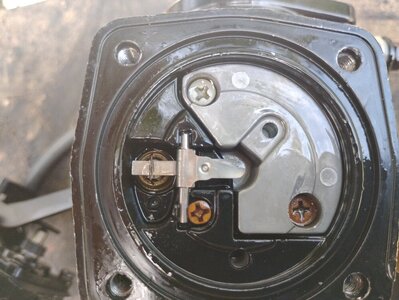

A few more things I noticed the action of the lever arm is very sticky , when you depress it , it does not spring back all in one action , the needle and seat is very cheap , I doubt it would last very long before it starts leaking , I did not check the popoff because the horseshoe for the seat isn't even there , what would be the point ?
When I tried to depress the lever to open the needle it was stuck , at minimum the needle and seat, lever pin, spring, all the screws, jets and the valve on the jet cover would have to be replaced, then it might actually half@$$ work .
Maybe it's worth $80.00 for parts but I am not seeing any value here really , maybe if you needed a complete accell pump to fix and OEM carb with IDK?

That midrange transition bog and not getting up on the high speed circuit is that "anti-siphon" flap valve on the jet cover. If that sucker is too thick they'll do EXACTLY that.
