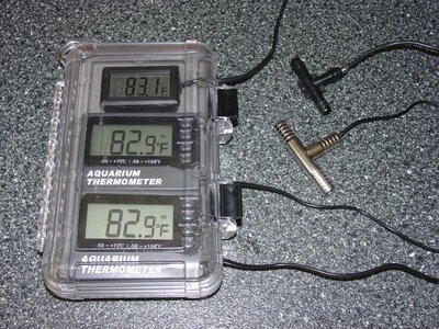

I use this setup to adjust water restrictors at the bypass fittings.
It's not permanent but it allows you see the temperatures while tuning.
D A M N good idea
Thats alright, I would have no idea what to look for, I usually figure If it I can touch the water at all its to dam hot and it needs more flow. Wow, thread dumping on my own thread, dont remember if you pm me the b pipe specs but what should I have the pipe screws set at? Would rather lean on the safe side...
