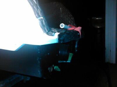

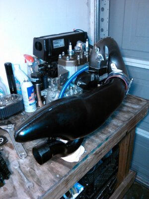

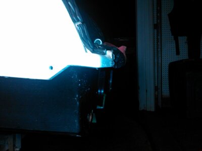

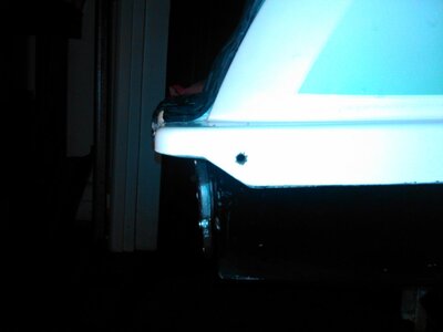

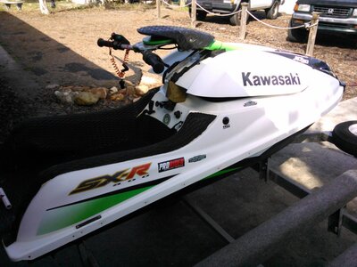

Been dropping some weight on this beast lately. If anyone is curious on weight, here you go. Hull w/everything except motor=240lbs. Engine with pipe=93lbs Total=333lbs dry. (Actually a little lighter today. Removed ebox bracket, exhaust support brace next to carbs, cut down throttle cable holder and removed bottom of battery box) Total mods, aluminum handle pole, removed bumbers, tdr waterbox, pipe, lightweight flywheel, butterfly chokes removed, fuel selector removed, rail caps removed, hydroturf, footholds, exhaust endcap removed, tail end cut flush with tray(way less drag), d cut ride plate, bored nozzle, hood liner removed, bilge pump, primer, milled head. Night and day difference from stock. Keeps on getting better.
