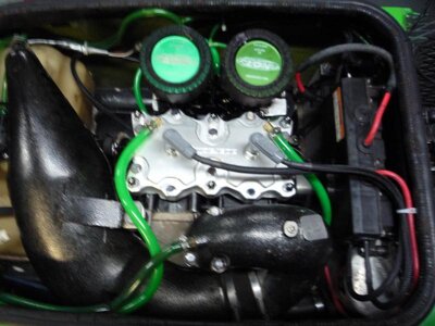

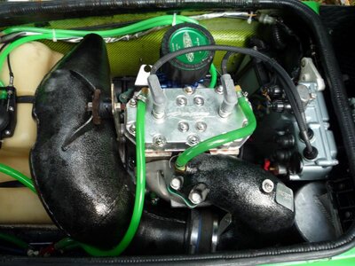

the mainfold and maybe the head pipe are different between the kawi and yami. You need the Yamaha manifold for sure. I tried to do this when i built the yamasaki and the kawi exhaust would not work on the yamaha engine. The bolt holes on manifold are rotated different, it angled the head pipe into the side of the hull.
Here you go: First pic is WB complete set up on Yami engine, 2nd is Complete kawi
