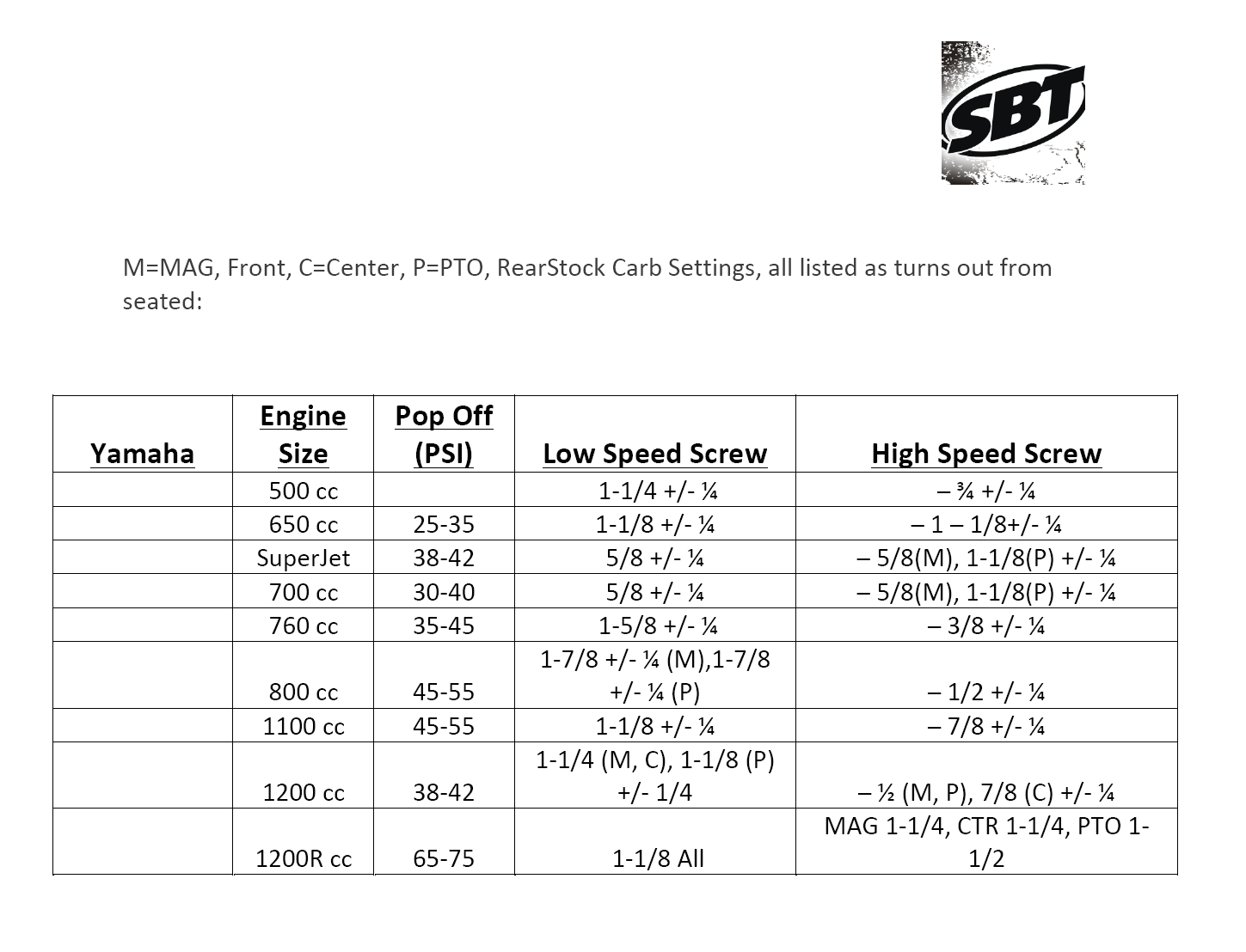

i did find this from SBT regarding stock pop offs, but im reading this chart and it says 650, and then superjet underneath it, and there is a huge difference between the two, which should it be?
