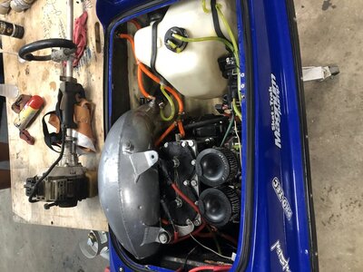

Hey guys I have this Factory dry pipe on my RN Superjet my EWI took a crap. I want to ride it for the remainder of the season and just want it to run somewhat well. What are my best alternatives a flow valve? Or something? I was at my lake house and the water box was hot as F$&k! Cause the EWI goes to the stinger so for the time being I just tapped off cylinder cooling line to feed the stinger/water box which cooled it but it just has no performance obviously I’m open to all suggestions boys. ******I’m getting rid of this pipe after the season so who ever reads this and knows anyone who wants it let me know!

The pisser's should never be tee'd.
I would run a tee on one of your cooling INLET lines (assuming you have dual cooling which you should) and run a hose to the stinger with a restrictor jet. This is how the r&d dry pipe designed their cooling routing and it would be the same procedure for an ecwi solenoid.
What type of restrictor jet?
A mikuni carb jet. I'd probably start with a 150 or so. There are fittings you can get to hold it in line. (You can also get other types of water restrictors with plastic inserts of various sizes). Flow control is not the same thing. That just allows water flow through it once a certain line pressure is reached. It's not uncommon to see both of these items used together.
The main thing is the carb jet will slow the water flow to the stinger and not starve your engine of cooling water since you're tee'ing into an inlet line. And it's also a tuning item for the pipe

I have mine setup exactly like my power factor lay down pipe minus the flow control valve. 2 feeds in the manifold, 1 out of head going overboard, the other into bottom inlet on chamber. Top bung feeds the stinger with a 120main jet in it. Outlet near stinger goes overboard. Works great for me without ewi. Bump up compression and advance timing a few degrees and you'll never miss a b pipe.
dual solenoids seem weird unless you are using a module that would have the mani solenoid rpms on/off way different than the stinger. I would keep a steady flow to the stinger with the exception of flow control if you want. For the mani, talk to your engine builder on what rpms it should be on/off
I run a needle valve for adjusting flow currently to the stinger on this pipe. Love it - has been flawless and I will occasionally still check waterbox and exhaust tube temps to make sure flow is as expected.
