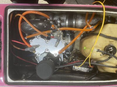

My 1994 square nose won’t start after full engine and carb rebuild.Setup is a ported 61x with Mikuni single 44 ada head 36cc domes Coffman pipe lightened fly wheel boyseen reeds. Ski cranks but won’t fire. Things I have checked

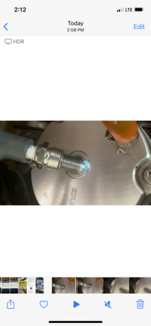

Electronics are fine I checked them on another ski good spark new plugs timing is set to stock tick mark. By passed start stop switch and still no fire just cranks fly wheel key is good and bolt is torqued to 70lbs battery fully charged
Carb is feeding fuel I can c it dripping out the Venturi check valve is good and when I try to choke it with my hand I can feel the carb sucking air tired using starting fluid and still no fire used genuine Mikuni rebuild kit
compression is 155 in each hole
Not sure where to go from here
