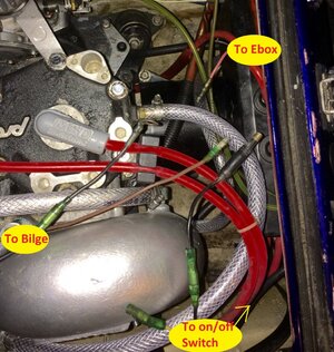

I recently tore down a 1993 superjet that I bought over the winter and finally got it put back together. One of the last things i need to do is to re-install bilge. I honestly can't remember how the previous guy had it ran, but i know that he had it hooked to the ebox somehow.
I took a picture of all the wires involved and did my best to label everything. Can anyone help me out on which wires to hook up and where? (excuse the mess, still have to button everything up)
From Ebox - Theres a Red and a Black wire (black wire had other end of fuse holder but it ripped off)
From On/Off Switch - Theres a white and a black wire (black wire has fuse holder with 5A fuse)
From Bilge - Theres a brown and a black wire (black wire has terminal on it)
