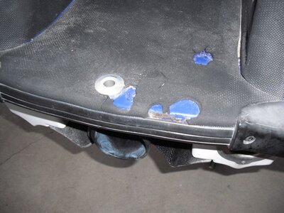

If you are riding in the surf, you'll want to "D" cut a stock ride plate. Basically, you are cutting a half moon out of the back edge of the plate.
You can kind of see it on mine. If you do a search you will find all kinds of info on it.
