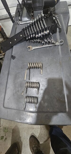

I broke the pole spring that I had been running on my superfreak for years. I grabbed a jetworks spring and put it in. As I was installing it I noticed it was much easier to install than the previous one. Then I noticed that if I had the pole all the way up the spring wasn't even touching and it would let the pole all the way down to sit on the hood. The old one would hold the pole about 10-12 inches above the hood. I went back through my stuff and realized I had been running a blowsion HD spring. So I bought another one. It looks identical to the jetworks spring and not like the blowsion that I had been running. The Pic is new blowsion on top, jetworks in the middle and old blowsion on the bottom. Does anyone still make one like the old blowsion?

I broke a Blowsion pole spring 3 seasons ago, tacked it back together, then welded a nut over the tack to tie the pieces together. The heat from welding made the spring a lot stiffer. Pole is weightless while riding, even off the bike it will go to full mast just from the motion of the ocean!
