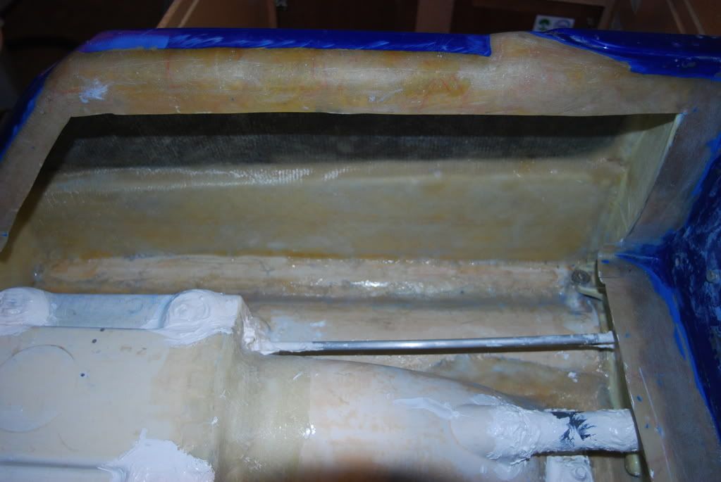

I'm getting ready to chop out a section of the ski for a refoam job. I took a couple pics of where I think I should cut? Any advice before I start cutting would be great!
BruceSki
Formerly Motoman25
Long Island
looks fine to me... just be careful you dont plunge the grinder into your exhaust tube when you cut near that area and you should be fine
stanton
High on jetskis.
atascadero,ca
gonna want to go further back with the cut on the bottom, reaching the foam and sanding in the back corners is the worst part.
