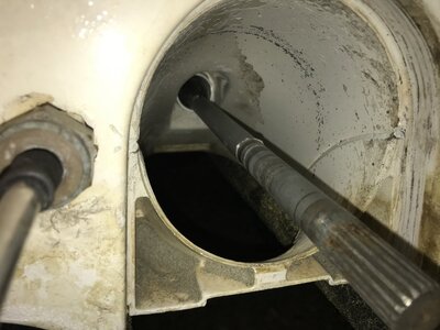

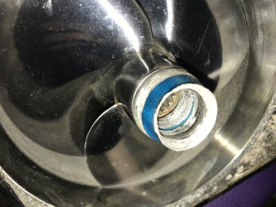

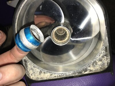

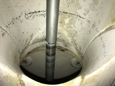

So after riding a couple weeks ago, we went to brap the water out of the 750 and when it started we heard an AWEFUL squalling metal on metal sound. I pulled the pump last night and this is what I found. The nose cone on the impeller seems to have dislodged itself from the impeller. I’ve been studying and have a new Hooker 9/15 and Jetmaniac pump and mid rebuilds. After pulling the pump the bearings feel fine. The goal is to have this ski back to be rideable by my 30th birthday on June 16th. We have 4 skis now and my goal was to have a birthday party at the lake. We rented a lake house with a private dock! Anyways I’m thinking that I can get a new driveshaft and then how else can I get this back working? I’m thinking of saving the rebuilds and impeller for when we paint the ski this winter. Please let me know the easiest fix for this for the time being, as I have the parts to overhaul the entire driveline later. So what should I do? Thanks!
