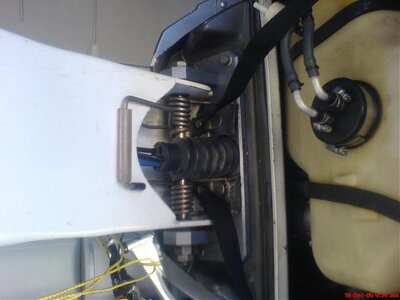

a pic of pole and bracket as you can see i have all the springs i can fit to make it lighter
http://www.x-h2o.com/images/attach/jpg.gif
